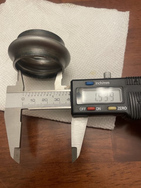

Okay so there is a 100% all stop to this. By removing the pinion I lost all references needed for re-assembly. In addition to this ZF does not publish the pre-load needed so that the crush sleeve can be correctly set. Also a crush sleeve like a axle/pinion seal is one time use only. Re-using it again and you run the risk of crushing the bearing in the race. No thanks.
ZF nor dodge sell crush sleeves as from what I can see on store.mopar.com. I have two options. Use another differential that is brand new, drain, pull the entire center section out, remove ring, go to town.
I have another option. @zhc kindly sent me a differential out of the charger, it was in good condition when removed. Drain, rip out center section, remove ring, leave pinion. Prior to this measure backlash. Would avoid pinion issues.
I have reached out to
to see if they have a solution for Hellcats or something that may work. Right now eating dinner so I will take my measurement tools to it in a bit to get dimensions. Also a very good option to the crush sleeve, you can torque to hell and it's not going to become useless.

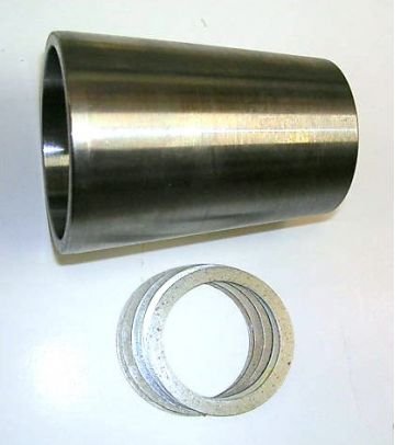

The pinion crush sleeve was the weak point of the 8 3/4 back in the day. I remember someone made a kit with a solid bushing and shims. maybe something like this can be made.I can check bearing preload as I have a 3.09 and a 2.62 spare. It will be late tomorrow though.

I think I used the one from mancini racing back then Looks like this

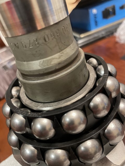

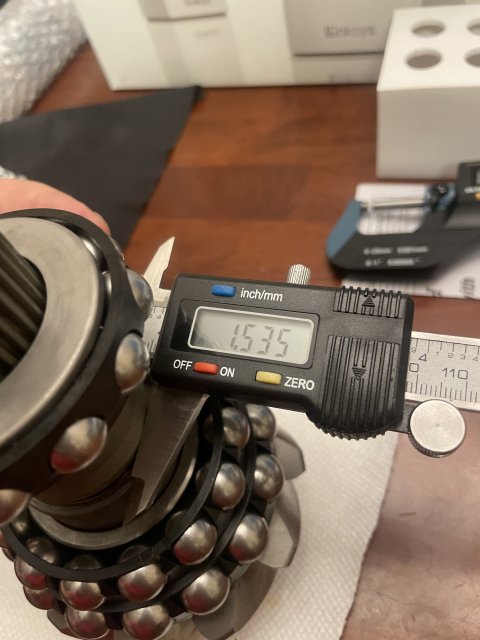

So I am once again in believe that dodge/zf engineered these to be non replaceable. the shaft has a taper and then at the bottom of the taper an 1/8th of an inch is machined out so you cannot place shims at the bottom and is required for a kit like that.
if you were to make a crush sleve eliminator then it would have to be machined in such a way that the bottom would fit at the taper and then the top hole machined to the rest of the shaft

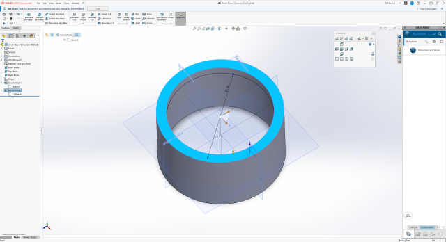

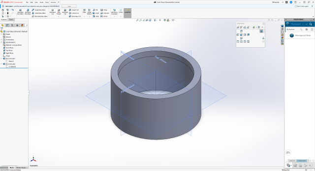

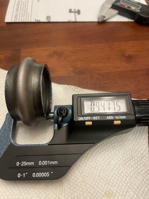

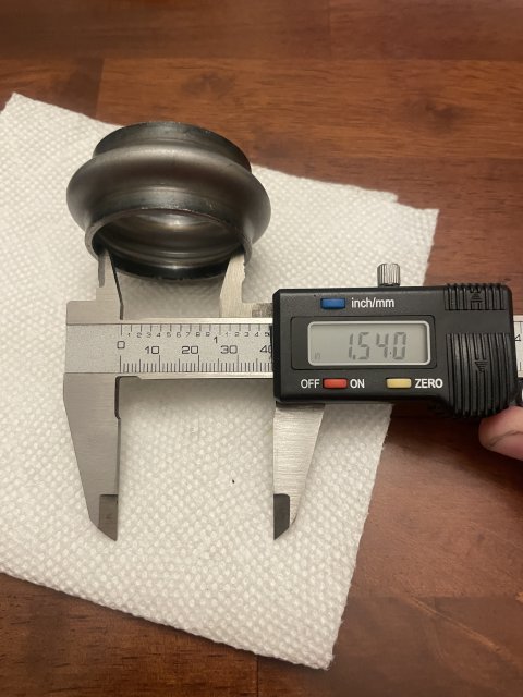

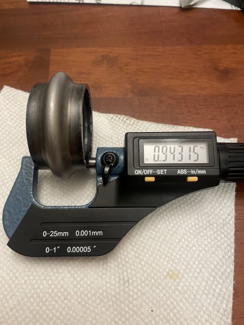

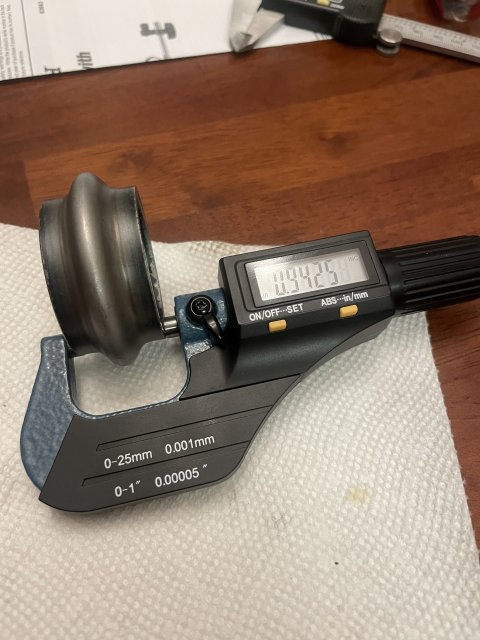

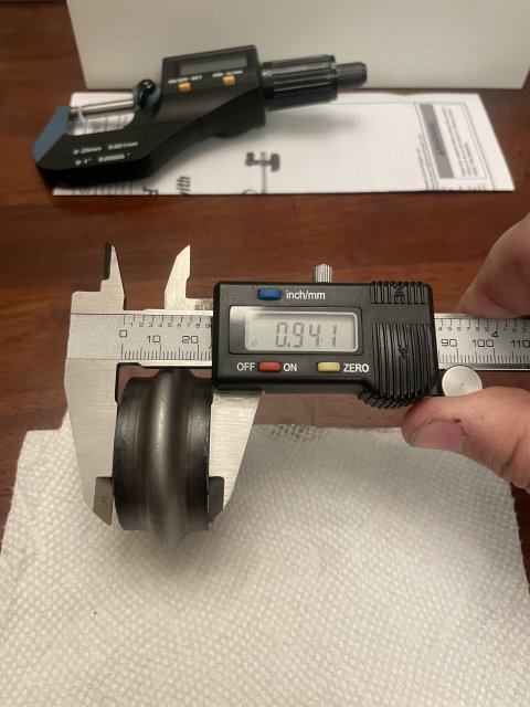

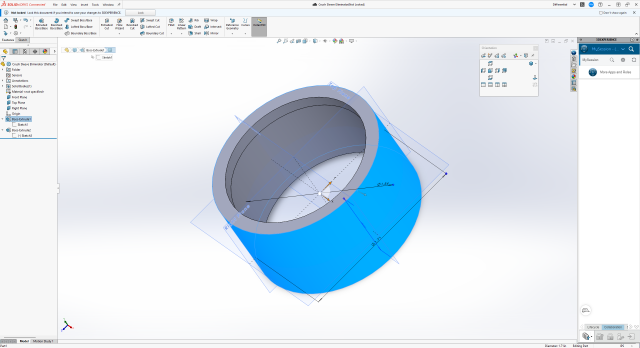

@Unholy707 and I have been talking about CAD work and I'm like I'm such a goonie right now. Fired up solidworks:

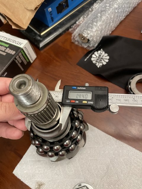

Top of shim has 1.440 ID

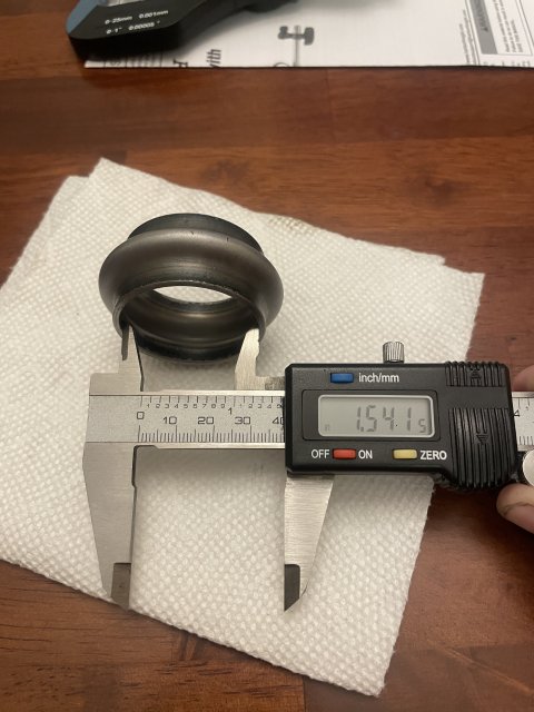

Bottom of shim has 1.54ID. Whole body has 1.71OD.
Shelf for shims to rest against is 1/8" thick. Tolerances were left a little loos by .001 for fluid
I went with a overall height of .942" as that seems to be the middle of the road. Shims would be custom sourced to match the shelf ID/OD (37mm id, 44mm). Just in case shims would be in a five pack: 5 * .001 = 0.005 of play. I thought about ten thou: .0001 for play but that is ridiculous. This is not really that precise in nature and a guesstimate at best. Thoughts? Going to contact the local makerspace tomorrow to see if someone can rough it out if I got pick up some stock at the metal supply place.

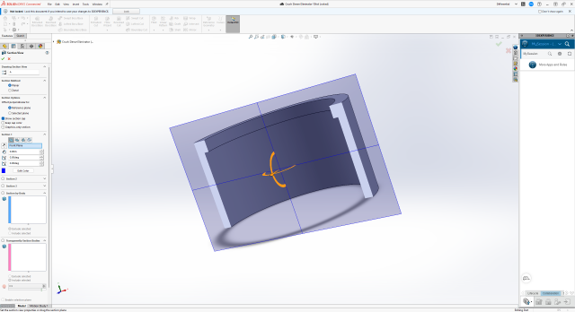

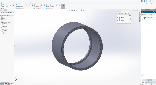

Thread Starter #1,834
Visualizing the shelf. Good fight, good night. Also asked on the MSHS group on FB if anyone else has done this before I re-invent the wheel...
